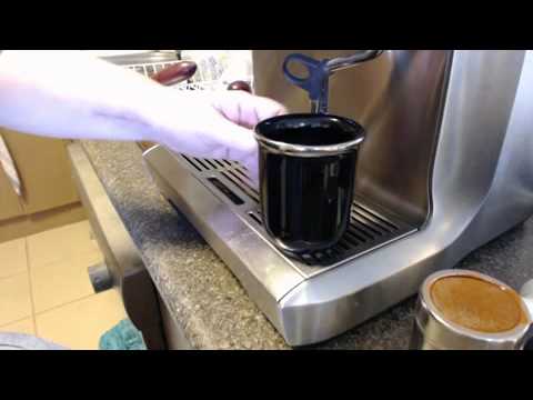

  • C-man here is my video :) excuse the towels on the floor, leaking dishwasher, oh and my arm for people that don't know, surgery scar from broken radial bones, my other arm that you never see enough of has 3 of them around my wrist.
  • on 1363759667:
    Thanks SS, it looks like you start low and just work your way up and get some air later rather than sooner different to what everyone else is saying, but it works for your machine, also having the jug more steady resting on the tray where I am holding mine in the air may make some difference. It looked a little thin when you first poured it but seemed to work well in the cup all the way to the bottom of the cup, My wife watched and approved that is just what she wants your machine takes twice as long to steam as mine even with the smaller 2 hole tip. mine actually looks similar in the jug, but comes unstuck in the cup and duds out. WHAT MILK ARE YOU USING? you know the thick stuff at the bottom, once I had a full jug like that but never again.
  • I used to hold the jug but not being able to actually hold even a jug of milk stopped that and I just 'had' to have coffee, so it came from a necessity rather than a technique :) Thin - actually now thinking about it, the video is how I do milk for me, when I do milk for my OH, I just put the tip in where I start in the video and it stays there until it's hot enough.  It is slightly thicker, more air throughout rather than majority of it being from the top half maybe. LOL your wife is the same as most of my female friends, they all agree that that is how they want their milk, I know it's not the 'done' thing but I like it. I use ONLY (no idea what I'll do if it ever stops being produced) Pauls Farmhouse Gold.  I don't drink milk other than in coffee and hot/iced chocolate so for me it's worth the extra money.
