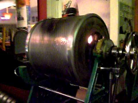

  • Richard I came across this roaster and thought it may be just the thing for your build [embed=425,349] KK
