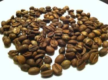

First crack came at 11.30mins, with what I thought was SC coming at 15.40mins. Pulled it almost immediately. First crack was relatively easy to hear, SC less so. The final roast looks a little uneven, but not worse than some professional roasts I've had, not sure if that's a characteristic of the harrar or not. Either way, I need to align the driveshaft more precisely (thanks for the tips on that KK) and get the springs on the agitator blade. I'm sure that at least some of the unevenness was down to the blade performance. No matter what, I was going to roast tonight and I'm not unhappy with the results. Thanks for all your help do far KK, Lacehim and AM!
